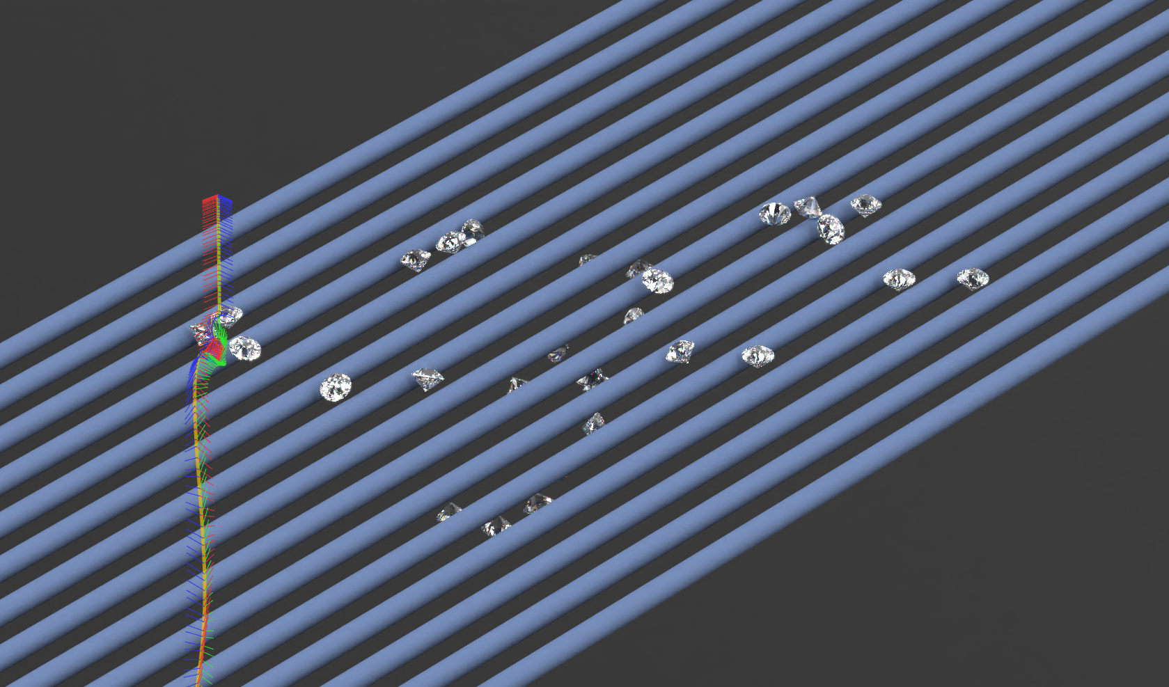

I also needed to have the diamonds not fall straight from the air since they would only rotate on first bounce so I added a few cylinders in the scene so they got twisted on their way down. Might help others who want a bit more dynamics:

Thanks! It’s really fun to play with actually and works much better in 2023.2 than earlier on. I was a bit subtle with changing the gravity to 1 m2/s which was still fast but with 0.01 it’s really slow. But I thought it could be cool to pan the cam around the falling diamonds. It will create a terrible amount of keyframes and long timeline but I only can render a part of it.

In some software you can give objects some kind of (random) impulse to get a motion to start with. But this actually worked really well after I changed the size so there were not a few stubborn diamonds which didn’t fall through. With only the force of gravity this also gives a more random idea even if you drop a nice pattern of diamonds on it since the cylinder grid is in a narrow angle they don’t all fall through in same speed which gives a nice touch of randomness.
